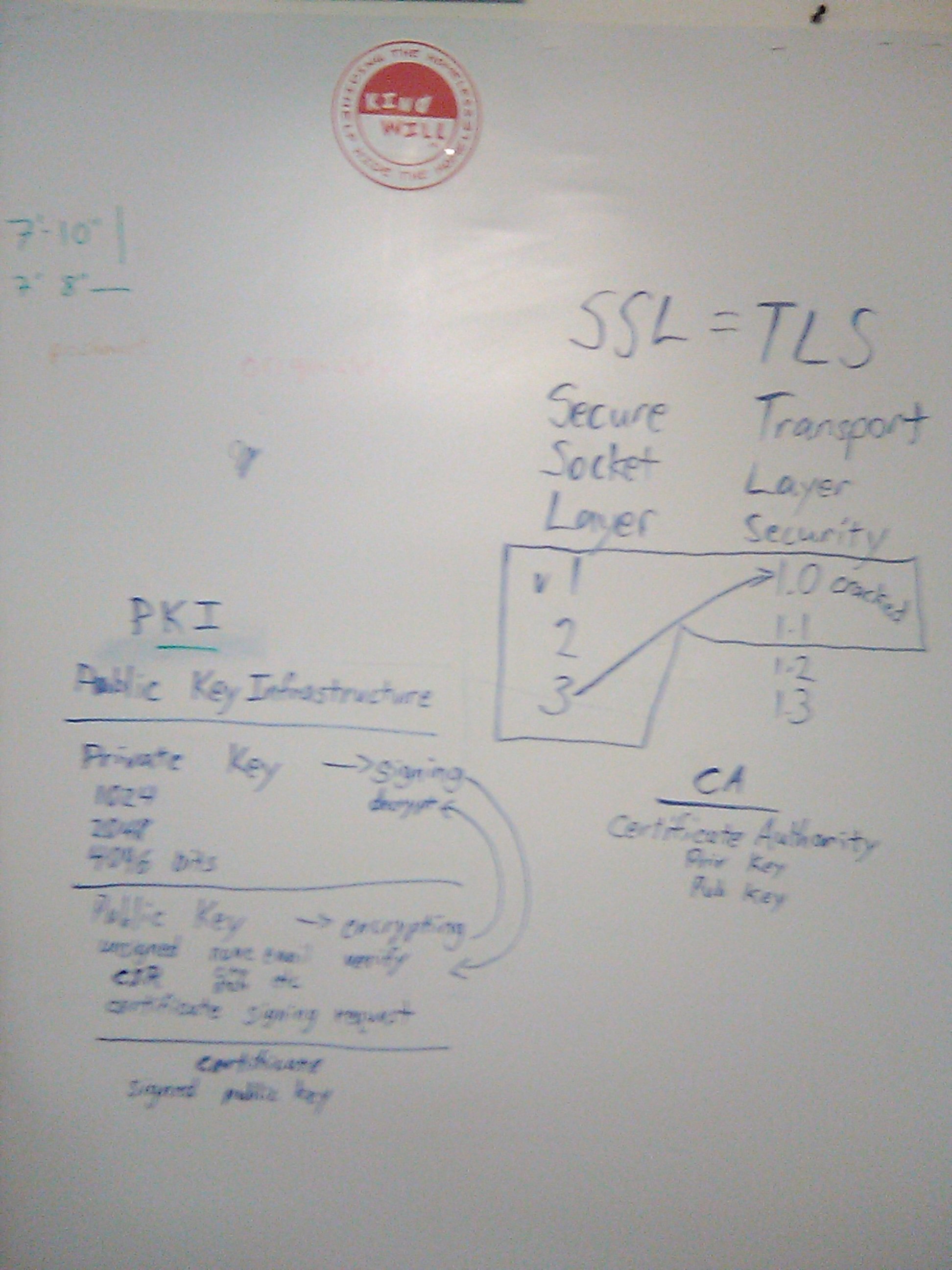

To get REACT to work with my Ubuntu Laptop, I also installed other packages. Node might be the server I launched using the npm start command which shows a woopy-do spinning REACT Logo. The goal I am aiming toward is an App I can't seem to make function, yet, and that REACT Program App will produce MIDI Pads on a different port (will also need https://www.gitxome.com:some-other-port).
My understanding of TSL was based upon an explanation given to me by a smart techie friend employed at UCLA, as SSL had reached its limit and an even more secure TSL was created..
uh, I see that's TLS ~doh!
