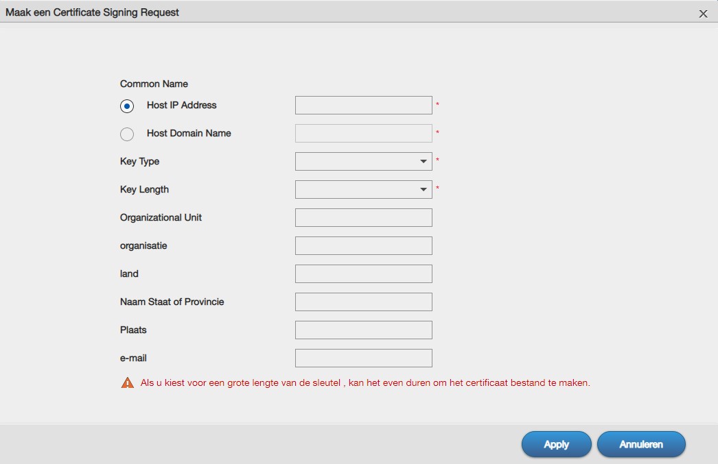

it has a possibility to create/use SSL. (see picture below)
not bothering to go into details why de system included certificate doesn't work at al.
but it also has an option to prepare a certificate, download it and...here it comes!! upload it to get it signed, have it returned and then i can import it.
sounds easy enough, only there is no way, really NO WAY to submit that file and get it signed. (step 4 & step 5 in the picture)

does this help?
it's the screen i get when clicking on the button "maak" (create in english)
yes, it's dutch
that first option simply sucks, it generates an invalid certificate. tried that.
my best option is the last one, but then i need someone to sign the request

and to prove my point, the screen in english in attachment
they say there "certain" so free to contact any CA
