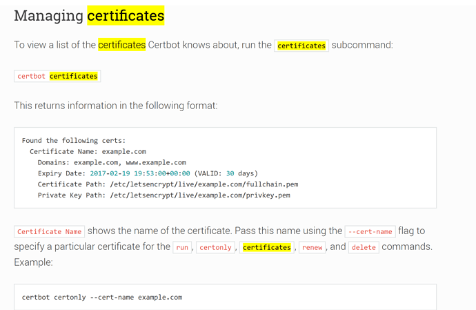

How do I renew a specfic certificate by its name?
certbot certificates
lists your certificates, what is the syntax for renewing one from this list?
these are not working
certbot renew domain.tld --dry-run
certbot renew -c domain.tld --dry-run
certbot renew -d domain.tld --dry-run
Currently, the renew verb is capable of either renewing all installed certificates that are due to be renewed or renewing a single certificate specified by its name. If you would like to renew specific certificates by their domains, use the certonly command instead. The renew verb may provide other options for selecting certificates to renew in the future.
read the manual :smiley:
Yes thanks, I am blind, did not notice the certbot --help renew
