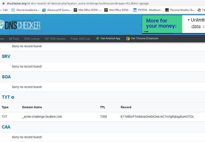

And DNS Lookup - Check DNS Records see it as well

All of your nameservers currently agree on the SOA serial number, yet are providing different answers for the _acme-challenge.faultline.com TXT record as your own checks confirmed. This usually indicates a problem with your zone files. You haven't said how your nameservers replicate their data between each other or whether you just modify them all by hand. But the SOA refresh window is only 2 hours and it has been 5 hours since others checked the _acme-challenge values. So replication delay seems unlikely at this point unless you're doing something out of band from normal BIND zone transfers.
Bottom line, all 4 nameservers must reply with the same value at the time the validation servers make the query. There's no downstream caching or TTLs to worry about. The validation servers will be directly querying (at random) one of your 4 nameservers.
If ns1.faultline.com and ns2.faultline.com are the same host (they currently resolve to the same IP) and that is the only host getting the updated TXT value, you have a 50/50 chance of any given validation attempt succeeding. Due to the multi-perspective validation that Let's Encrypt uses, there will be 3-5 total queries made (I forget the exact number) that must all succeed.
