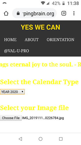

Here is a screenshot of a functioning padlock prior to the current issue.
From my perspective, https://absorpingbrain.org/ and https://www.absorpingbrain.org/ are currently using a valid Let’s Encrypt certificate issued on November 26.
The “VAL-U-PRO” certificate in your post was not issued by Let’s Encrypt. There’s no record of it in public Certificate Transparency logs, so it’s most likely not from any publicly trusted CA.
