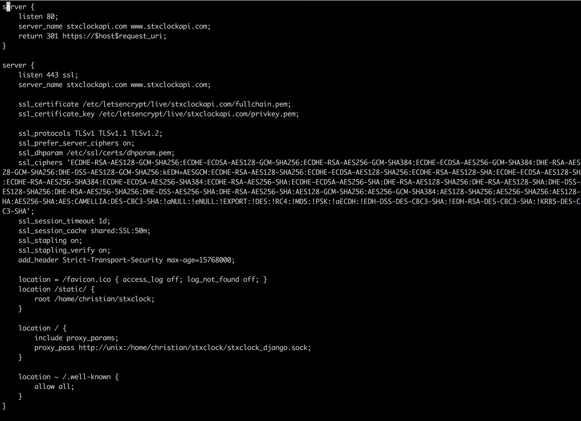

This is my “sites-enabled”:
You could try the solution from 404 on .well-known/acme-challenge/ - #11 by jongrover
In that post, the location for the static .well-known directory was changed to this. Alter your root path accordingly.
location ~ /.well-known {
allow all;
root /usr/share/nginx/html;
When I go to the IP-address, the test page works, but when I use my domain, I get the same “Your connection is not private” message.
Edit: to be clear, the sites-enabled file I showed is the /stxclock, not /default… Does that matter?

Hi @leBoer,
You are currently serving an expired certificate so getting blocked is what you should expect, I don't know what Safari does but it should block the access too.
Are you sure the renewal conf has the same document root used by your nginx conf?. I mean, you said you have put a test file inside .well-known/acme-challenge/ and it works, so if you have put that file for example on /var/www/.well-known/acme-challenge/test then your document root is /var/www/ and this path should be the same in the renewal conf for your domain that should be here /etc/letsencrypt/renewal/yourdomain.conf and in that file you should double check that the path of the document root for your domain is the same you are using right now.
Cheers,
sahsanu
Hi @sahsanu,
Thanks for your answer. I don’t actually have a /var/www… It’s been a while since I set up this server, but perhaps it’s because I run on Django and Gunicorn?
Hi @leBoer,
/var/www/ was just an example, what I mean, you created a test file here /some/path/.well-known/acme-challenge/test so /some/path/ is your document root. Do you have /some/path/ in the renewal conf file /etc/letsencrypt/renewal/yourdomain.conf ?
Cheers,
sahsanu
Hi @sahsanu,
This is what my file reads:
@leBoer, ok, so the renew is trying to use /home/christian/stxclock as the document root, the test file that is reachable using http://stxclockapi.com/.well-known/acme-challenge/test where is located in your hard disk? it should be located in /home/christian/stxclock/.well-known/acme-challenge/test. If the test file is there then the renew should work, if it isn’t there then your document root is not the same as is in the renewal conf and you should edit this file to correct the document root for your domains so the renew command could use the right one.
