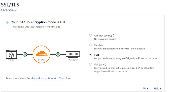

The issue is likely that you need to set your cloudflare SSL/TLS settings for that domain to use Full rather than Strict mode, otherwise Cloudflare redirects to https for you and if the particular http validation method is only listening on http port 80 then it will fail.
Hi @webprofusion,
The SSL/TLS encryption mode is set to Full. I haven't touched that. Thanks.
