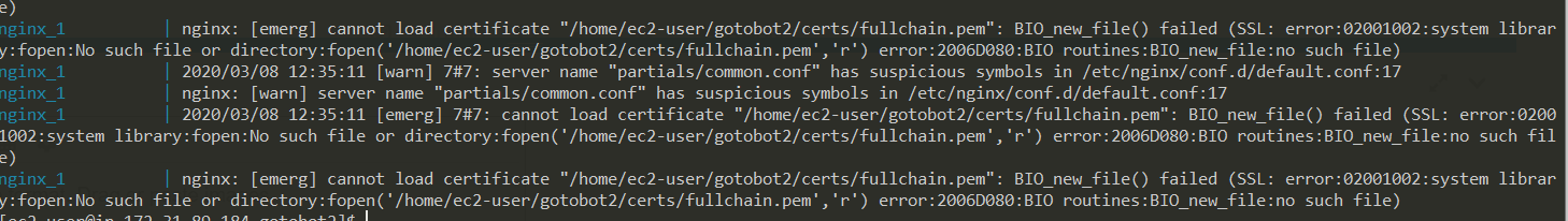

This is your only problem: Error cannot load certificate "/etc/letsencrypt/live/domainname/fullchain.pem"
You might need to enter that container while the validation is going on and read the nginx error logs. (maybe docker-compose logs will help you)
In those logs is only this:
And I’ve “solved” this by copying the certificates into a local repo and loaded them from there.
So my error remained this:
