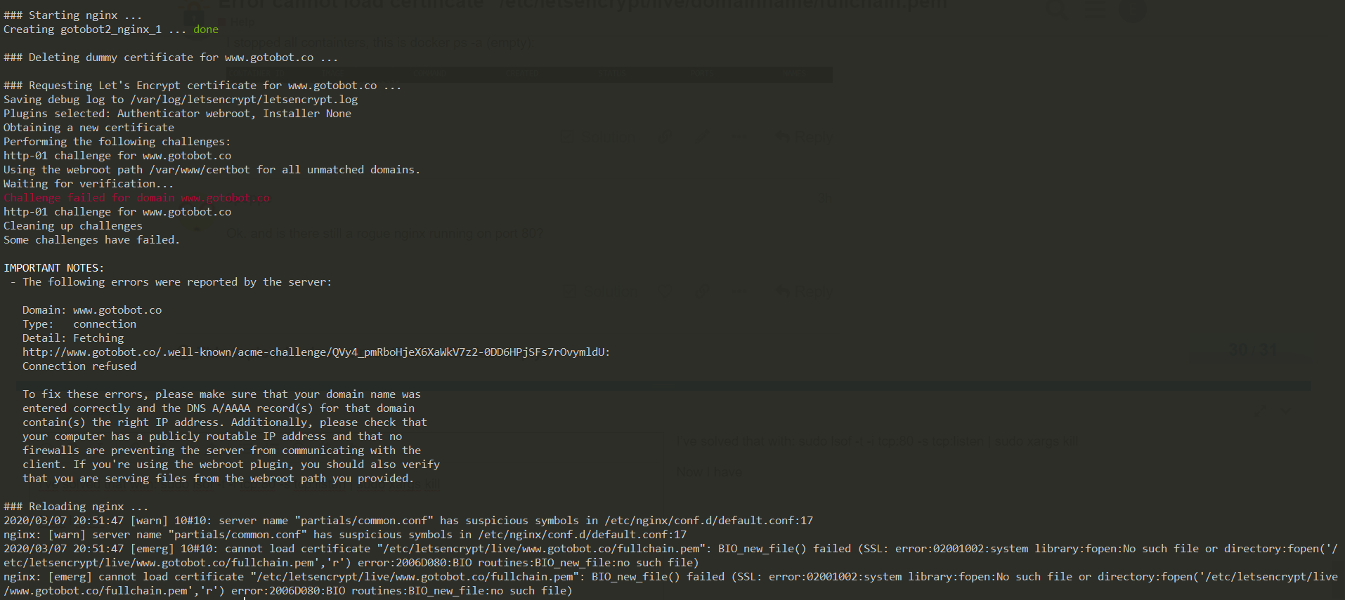

Now I have the same error I had before + the one from docker-compose…
I’ve run that script I showed you in posts before.
Connection refused.
Meaning “there’s a firewall somewhere blocking validation”

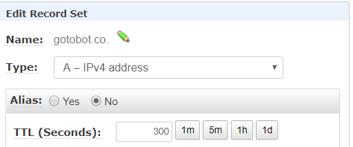

it should be ok. the ttl should be somewhere close, it’s part of the A record.
It was set to this?
Any ideas how I can solve that error from the image?
Ignore this ttl stuff, your config is ok. It was my resolver doing stuff.
The error in the last image could be transient, you could retry and see if it disappears.

I tried multiple times to rerun it and it didn’t work…
you’ll have to wait. I can see that record in caches around the world but not in your authoritative servers. try again ~tomorrow (in 14000 seconds at least)
Okay, but do you maybe think I should somehow add some permission in that script that I sent you so they can see those files because they actually exist so I don’t understand the issue.
