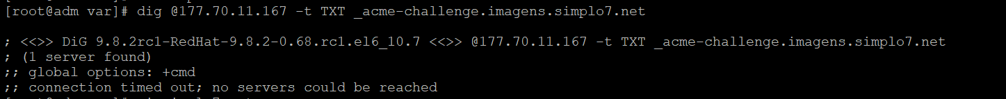

You might want to check if your primary DNS-Server (the one you configured to be used by certbot) serves the record during runtime with
dig @your.DNS.IP.address -t TXT _acme-challenge.yourdomain.something
This should show you the current challenge stored in DNS.
Me retornou este erro porem neste domínio tenho outros subdomínios que funcionou o dns para gerar o certificado.
