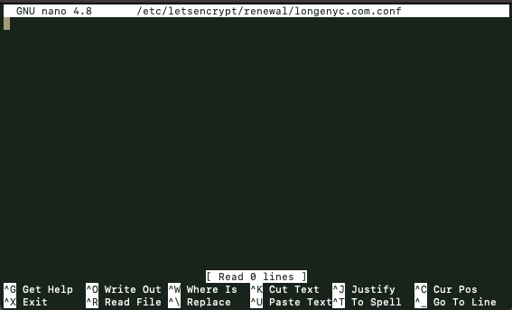

I used the sudo nano... command to open it and it is empty:

All the actually important files are there. You could perhaps try to restore the configuration file with the contents:
# renew_before_expiry = 30 days
version = 0.40.0
archive_dir = /etc/letsencrypt/archive/longenyc.com
cert = /etc/letsencrypt/live/longenyc.com/cert.pem
privkey = /etc/letsencrypt/live/longenyc.com/privkey.pem
chain = /etc/letsencrypt/live/longenyc.com/chain.pem
fullchain = /etc/letsencrypt/live/longenyc.com/fullchain.pem
# Options used in the renewal process
[renewalparams]
account = abcdefg
server = https://acme-staging-v02.api.letsencrypt.org/directory
where the abcdefg needs to be replaced with the hash found by running
ls /etc/letsencrypt/accounts/acme-v02.api.letsencrypt.org/directory/.
Not sure if Certbot will accept a configuration file without the authenticator configured, but it's worth a try.
