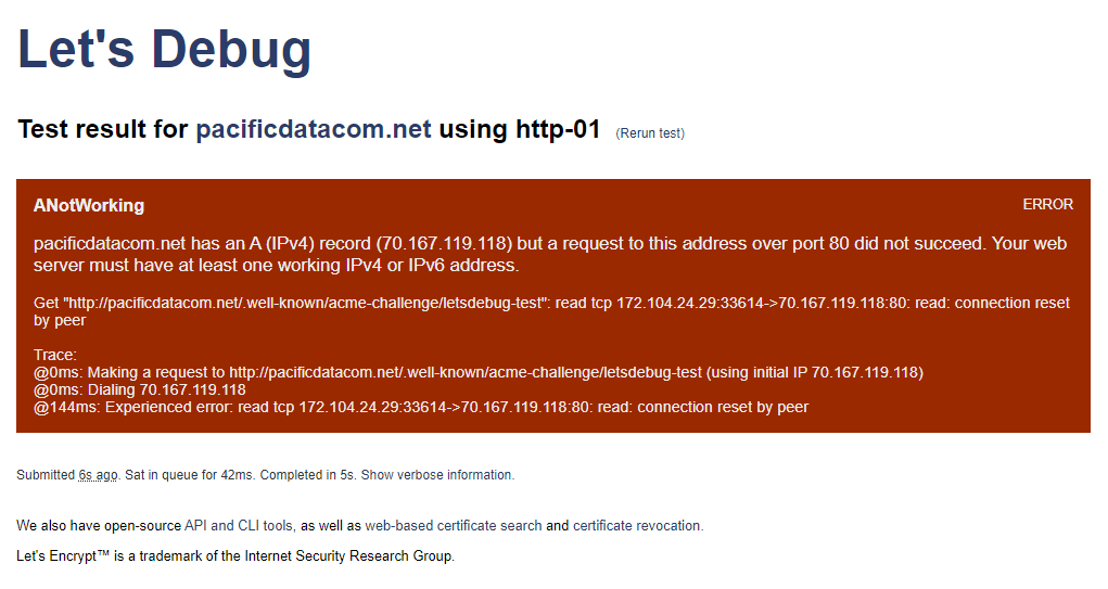

When I run lets debug 3 times I get 3 different messages.
I'm confused about the time discrepancy.
The LD error is severe.

But LE and LD both fail to even reach the HTTP site...
So, you must be using some kind of GeoFencing/Location blocking OR IPS OR IP block list that is preventing the challenges to be served.

As far as the certificates not updating I am starting to thinking its something SonicWall did with the firmware update but I have know idea how to figure that one out. I just posted on SonicWALL's forums, I will let you know if I ever figure this out.
I think the same. You could try asking at their support forum.
The key is the Lets Debug response. If it cannot consistently see your server then you won't be able to get certificates from Lets Encrypt. Given you got inconsistent results I would look at settings in SonicWall that relate to "intelligent firewall" or "adaptive firewall" or "smart firewall" - something like that. It feels to me like it is adapting to a pattern in the Lets Encrypt requests and treating them as threats (mostly). Mind you, I am guessing here but that's where I would focus efforts if it was my system failing.
