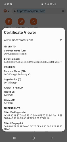

So… here’s what I’m getting:
It took me a few minutes because I made sure to fully clear my cache in between.
I am noticing random redirects. Sometimes http won’t redirect to https. Sometimes non-www redirects to www. I think there are a lot of conflicting settings/rewrites happening.
From the images above, you can see that it’s using your old certificate.

Be careful though. I get various behavior depending on how recently I've cleared my cache. I also am only getting the OLD certificates now.
