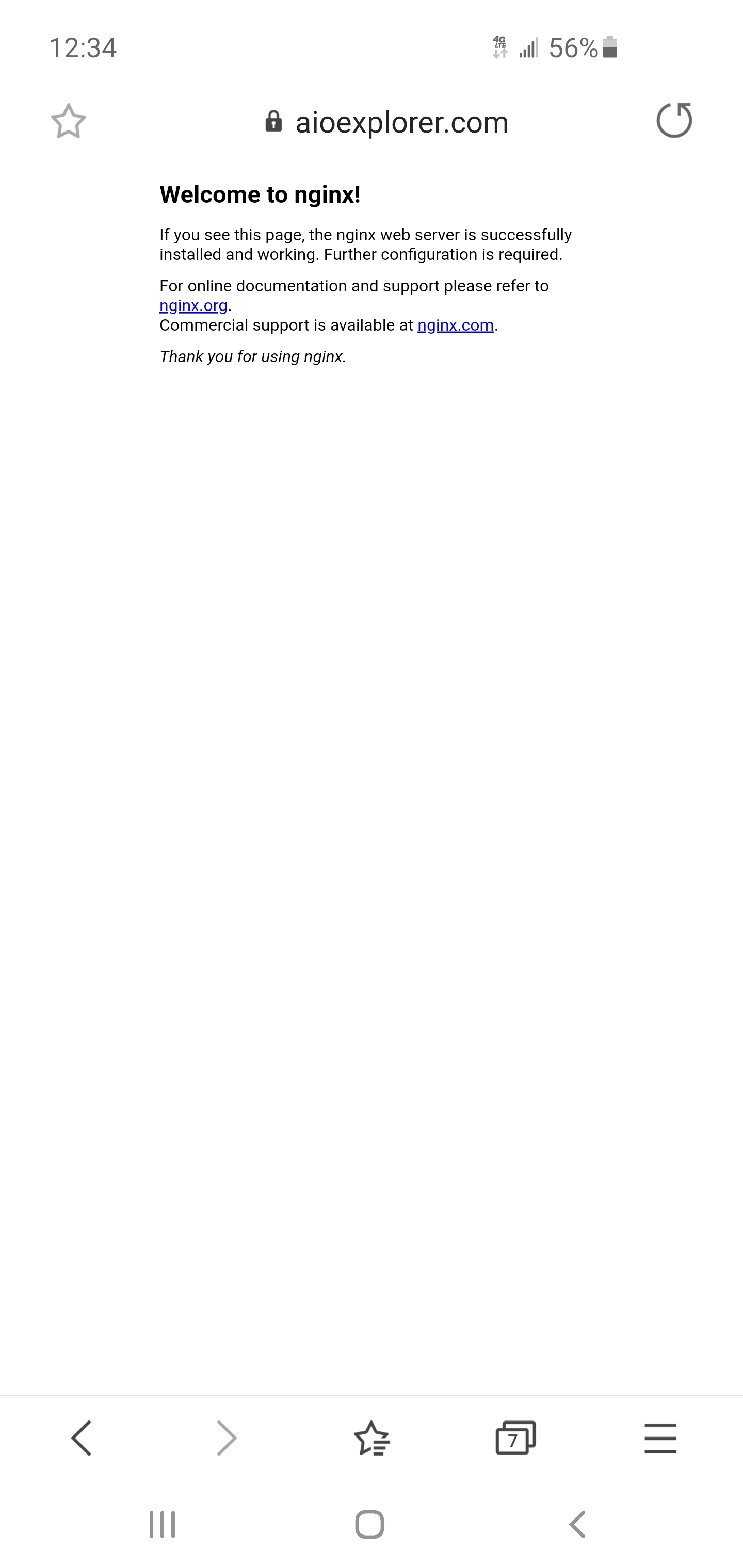

Interesting. So it looks like your new cert got installed for the default nginx for aioexplorer.com. It seems confusing that you have separate blocks for both. You honestly need /etc/nginx/sites-enabled/aioexplorer.com.conf running for aioexplorer.com and the other 3 will cause you headaches. I’m still wondering why your redirect is not working.

I already have this one. It was working - right? But, now, for some reason, the SSL is getting deployed to default rather aioexplorer.com.conf, which should take me to the landing page or the webroot. Anyways, I have deleted the default from sites-enabled to see whether it makes a difference.

Is this actually named aioexplorer.com.conf?
Yep. Now, it looks like www.aioexplorer.com is working. Could you check from your end?
