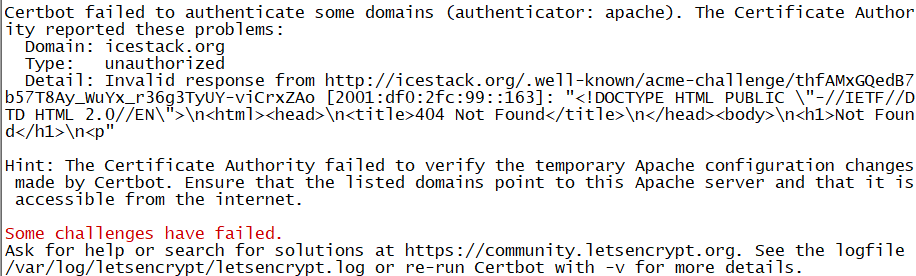

Certbot Some challenges have failed
helloo.. please help me :sob:
My domain is: icestack.org
I ran this command: certbot --apache
Certbot failed to authenticate some domains (authenticator: apache). The Certificate Authority reported these problems:
Domain: icestack.org
Detail: Invalid response from http://icestack.org/.well-known/acme-challenge/9wDBPukQrMSARCOwixGxGB3Y_43kJkVMBDgGNPK6kJg [2001:df0:2fc:99::163]: "\n\n404 Not Found\n\n
Not Found
\n<p"
Domain: www.icestack.org
Detail: Invalid response from http://www.icestack.org/.well-known/acme-challenge/_xoFeRvFsXIkktG2L2fLtRAfHnaHa1WzJWQSDr-G0aM [2001:df0:2fc:99::163]: "\n\n404 Not Found\n\n
Not Found
\n<p"
Hint: The Certificate Authority failed to verify the temporary Apache configuration changes made by Certbot. Ensure that the listed domains point to this Apache server and that it is accessible from the internet.
My web server is (include version): apache
please help, anyone? thankyouu

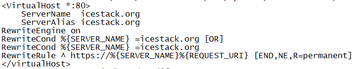

hellooo @raf , my VirtualHost configuration like this
And every time I do the process cetbot --apache, always come out like this
And I don't know what to do :disappointed_relieved:

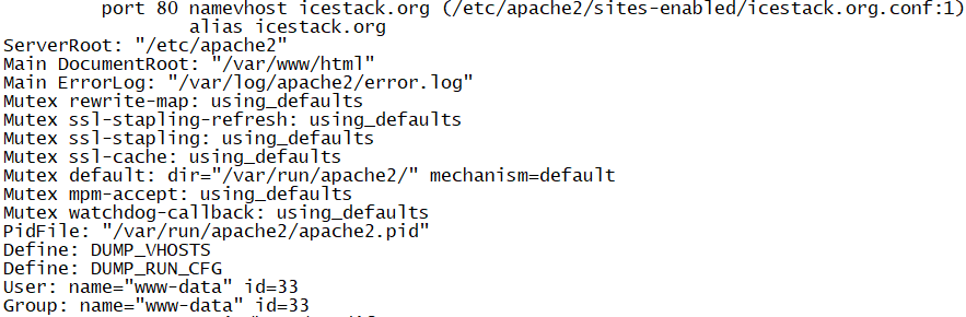

Thank you so much for replying to my message :heart: @rg305 @raf , I've updated my apache configuration, I'm trying to re-do the certbot --apache command, and there's another problem coming out.
apachectl -S

Here is an obvious one:
Servername  icestack.org
ServerAlias icestack.org
and followed with:
RewriteCond %{SERVER_NAME} =icestack.org [OR]
And the most problematic one:
<VirtualHost *:80>
[2001:df0:2fc:99::163] ... 404 Not Found
Listening on IPv4 only.
While DNS resolves to IPv6 & IPv4 IPs.
Note: LE will prefer IPv6 over IPv4 when present.
Addresses: 2001:df0:2fc:99::163
           103.163.39.28
Deja vu!
This shouldn't be needed. This should be enough for both IPv4 and IPv6:
/etc/apache2/ports.conf:
Listen 80
<IfModule ssl_module>
    Listen 443
</IfModule>
I thought so too at one point, but ended up realising that it's best to completely avoid any specific reference to IPv4 or IPv6. That way, both should work.
However, removing the IPv6/AAAA records from the DNS will "fix" this problem, but it's
not ideal. Ideally, both addresses should work.
I wonder what the /etc/apache2/apache-le-ssl.conf file is. I never got one of those.
The only *-le-ssl.conf files I've seen are in /etc/apache2/sites-{available,enabled}/*.
As for:
ServerName icestack.org
The ServerAlias line should be:
ServerAlias www.icestack.org
It doesn't make sense for the alias and the name to be identical.
