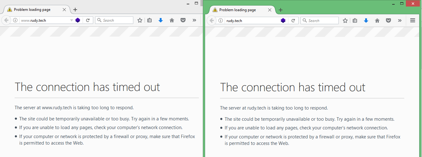

hi @cyberjar09
I think the challenge is with timeouts to your site
I tried rudy.tech and www.rudy.tech and was not able to connect to either
HTTPS versions of your sites seem to work so I am going to narrow it down to a server config not listening on HTTP port (80).
I can confirm only port 443 is listening

Something in the report does not add up:
  1. Google chrome is able to access the site but Firefox cant
  2. when I ran nmap I can see port 80 is open

not really
review your firewalls and anything else that may be blocking connections
