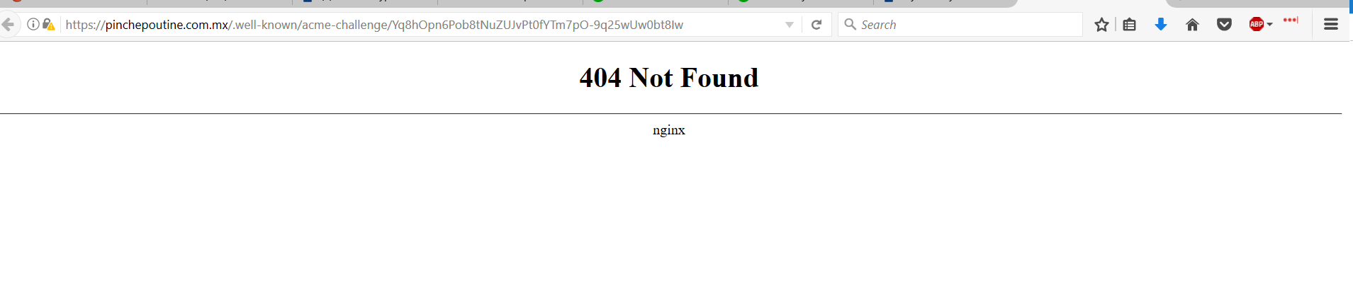

Hi @xpat
Your websites seem to be redirecting HTTP to HTTPS
Also even if you browse to the locations in the browser over HTTPS there is still no file present
A common cause for this is that NGINX webserver roots are configured to point to directory A while the webroot is elsewhere. You should compare what you pass -webroot -w /var/www/pinchepoutinecmx with what your web server has configured.
The other common cause of this is …htaccess files not allowing users to browse to the acme directory
A third possible cause is MIME mapping but this crops up on windows systems more
A common troubleshooting approach
Place a TEST.HTML and a TEST (no extension file) in your http://pinchepoutine.com.mx/.well-known/acme-challenge folder
Browse to it with a browser if you are able to receive files you are there.
The only other thing to check is that Certrbot is putting the files in the correct direcoty

Thanks, Andrei. I manually added the directory acme-challenge and then two files, test.html and test. (I had done this before I asked for help) and now again after getting your message. I can’t browse to those files. I still get 404 not found.
I installed the certificate on 10 other websites about two weeks ago. I forgot about this one, and just came back to it. Probably I have something misspelled or the webroot is wrong, as you suggest. Honestly, I posted my request for help because I thought the problem might be related to the .com.mx extension.
