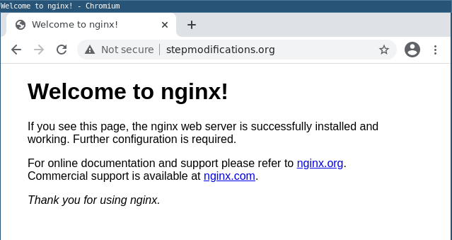

To me, it suggests the above snippet is not actually included in the virtualhost for stepmodifications.org.
The other thing peculiar is that you posted this configuration:
so any request to port 80 should get a 301 response, right?
That's not how your server behaves:
$ curl -i 138.197.49.211
HTTP/1.1 200 OK
Server: nginx
Requests to my server work fine, and you can access it to verify (stepmodifications.org). Redirects to www and port 80 all redirect to this URL. My relevant nginx server blocks:

I can't see anything wrong about this config such that nginx would be sniffing it's default path other than it cannot find this one. easy to miss small thing though.
Well, not according to curl^^.
(Accidentally edited this post instead of posting a new one, blah).
but if you use http://www.stepmodifications.org, your browser will redirect to https://stepmodifications.org, so that seems contradictory. Also, port 80 is open, but it won't serve up anything from there. That curl command you used just pings port 80, no?
It seems contradictory, but your browser behaves this way because it is caching the HSTS rule that you are sending in your headers.
In fact, try from a fresh browser with no previous state/memory, and the result is:
no-hsts
Well, the Let's Encrypt challenge will always begin on port 80.
So unless you get your 301 redirect to work, the request is not going to end up being correctly served.
I'd try:
  1. Checking nginx -T to make sure you don't have any other default_server port 80 virtualhosts that may be competing with your HTTP 301.
  2. Killing off nginx fully to make sure that the effectively loaded configuration is the one that is actually on disk:
    sudo service nginx stop && sudo killall -9 nginx && sudo service nginx start
UR awesome.
Indeed, I did have a default.conf file that must've come from a recent update. It was conflicting with my listed on 80, since it was the first nginx inclusion.
