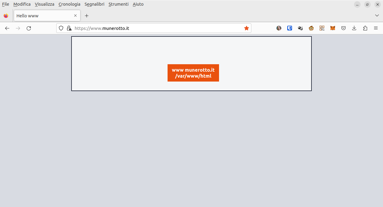

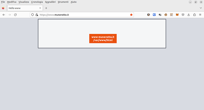

I removed from the www.munerotto.it vitual host conf the rewrtie rule to force the use od https for the incmin request on port 80. But the opposite...
An idea might be that the https' are missing. I'll try to add the virtual host for 443 again.
Using https://www.munerottoit finally, accepting the "nasty" certificate (expired), I receive the page:
The same happen for the nextmune (accepting shows my hello page)

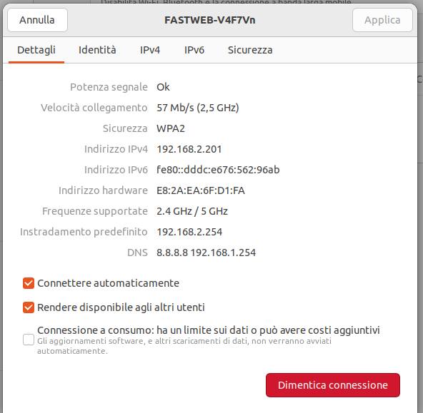

I think I found.
The working machine ha this conf:
so I have to manage the modeom/router to pass "8.8.8.8" as secondary DNS
Ach this damn modem!! :frowning:
It is so basic that the DNS can be changed there, it is hardcoded.
I tried to modify the resolv.conf via CLI but I failed. so II forced it, changing the last lines of the file redolv.conf
