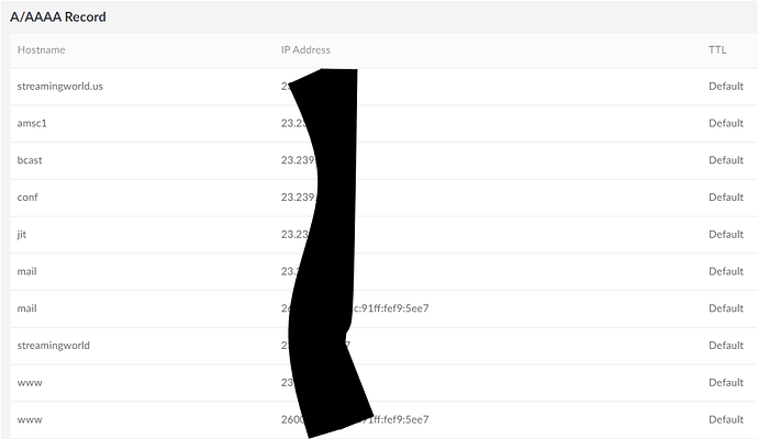

I am fairly new to using DNS. My Domain is with Go Daddy. My website is hosted by Linode.
I guess I am confused as to where I create this A record?
That said, my Domain Manager (Go Daddy) is pointing to my Linode Nameservers.
My Linode has an A record for streamingworld.us and just streamingworld.
dig streamingworld.us resuts in still no IP? Here is my web host A records.
You need to add an A record for “@” to the ip of the webserver.

So here basically is my issue:
Your IPv6 isn’t working. Let’s Encrypt prefers IPv6 when an AAAA record is present. It doesn’t do IPv4 fallback, probably due to security reasons (Let’s Encrypt doesn’t know the reason why IPv6 doesn’t work, could be a MitM trying to limit connectivity to make his attack vector better for example).
