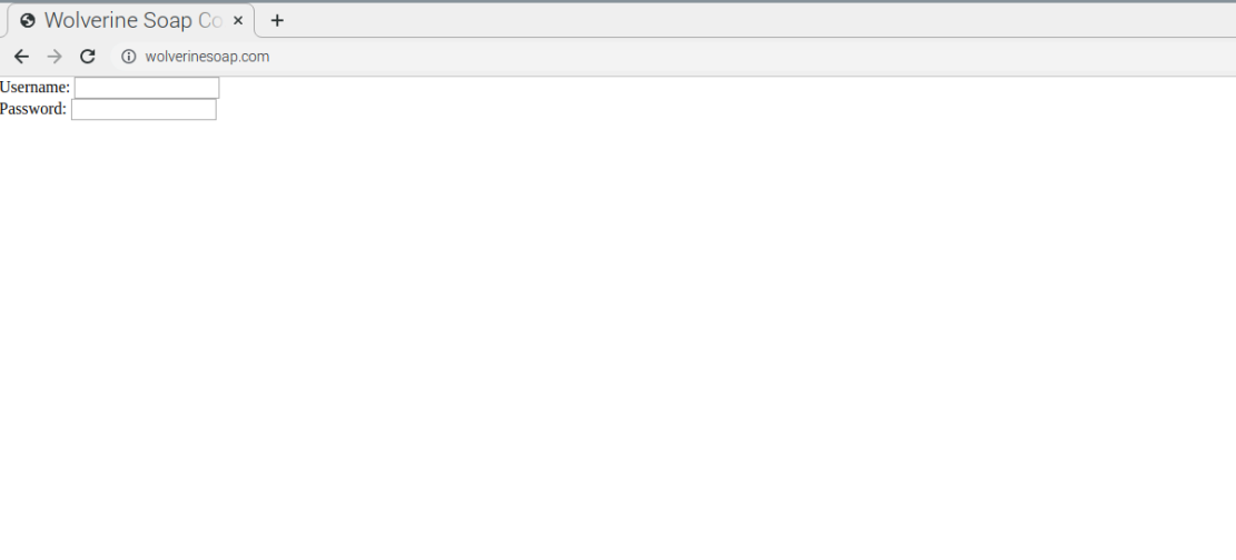

I cannot reach my server when typing in my domain name. I get the error “ERR_CONNECTION_REFUSED”.
I can reach my server directly by ip, but i get a warning stating that my page is not secure.
My website recognizes that i have a certificate even though its “not secure”.

I should also add that my domain name worked before I followed the guide.
I also have all of the correct files letsencrypt key, and nginx restarts without error.

Yes, the website has no content just placeholders.
Do I need to alter my domain setting in google?
Ok , so how can I connect locally and get the green lock pad showing?
