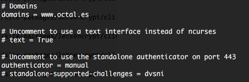

PD: my /etc/letsencrypt/cli.ini

it is, but not in my laptop. I mean, I thought webroot is meant to run in the server.
yes, my answer was ment to run on the server

Yeah, I had tried this before, and somehow I forgot to uncomment this line, but the output is still the same.
