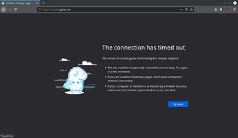

Also, the website is not opening in the browser.

but the website is not opening in the browser :frowning:
It's already opened (I guess)

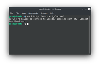

curl https://vscode.jgalec.me/
from that machine?
If yes, you have another firewall you have to open.
Port 80 answers -> compare it.
No, it doesn't :neutral_face:

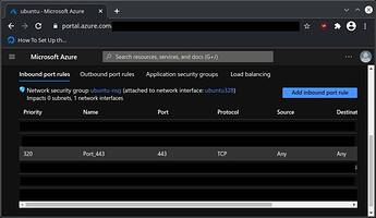

Ahhh goddammit I figured out, I set up an inbound rule to the 443 port in my vm network config

It's actually fairly common with some cloud hosters.. I don't know anything about those cloud stuff, but I do know some (or just one, I dunno) have two firewalls which can be configured separately..
