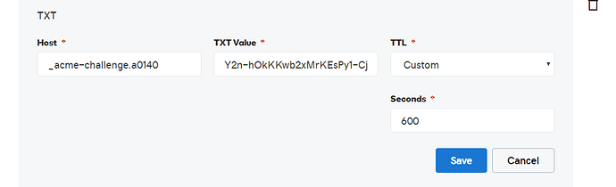

So you have to create an entry with
_acme-challenge.a0140
then the menu completes your domain name.

I already added it in the dns records but still not recognize
That’s the same old value.
If one value is checked and is wrong, you must create a new order -> new token -> new value.
Start a new order, add the TXT entry. Then use the online tool or dig to check if the value is correct. Then confirm it, so Letsencrypt checks the value.
