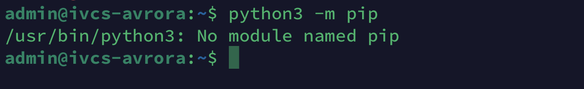

Do you have pip? You can also select pip (as OS) at the Certbot instruction page.
1.12.0 (it was originally). If I understood you correctly about LE accounts, but they are only 2 of them and they can be removed. I tried but a mistake crashes out.
No, I didn't have a pip
What's the output of:
python -m pip
Then why not just move the accounts folder elsewhere [as a backup] and rerun certbot?
Perhaps:
python3 -m pip
? Because you at least should have (had) Python installed, as Certbot is a Python application.
