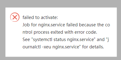

Maybe the ANotWorking error is generated by Nginx because it is not started and I can't restart nor start it:
Also when I run nginx -t I get this:
nginx: [emerg] open() "/etc/letsencrypt/options-ssl-nginx.conf" failed (2: No such file or directory) in /etc/nginx/sites-enabled/default:147
nginx: configuration file /etc/nginx/nginx.conf test failed
