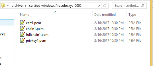

thanks @jsha
i tried with the folders specified with no luck
below is a screenshot
I can see certbot created the right directories (so no issues with /etc, which i honestly thought would be an issue)

I can see in storage.py that os.symlink is used and thought that was the problem however have a look at it i can the method is ok for windows
so the question I am trying to figure out is since we are fine to this point (csrs are created and keys are created) is there a way on not using symlinks at the final stage for the certs
will continue to wade through code
so closseeeeeeee!
SUCCESS!!!
Ran PowerShell as Administrator and no issues at all :smiley:
