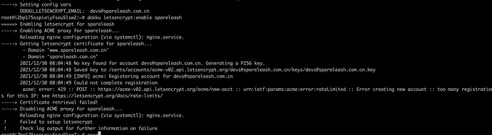

dokku letsencrypt:enable spareleash
**curl -iL http://spareleash.com.cn/.well-known/acme-**challenge/0KWcFQEUGnUmAE55Xdb1qAmZLp9HvBYV_5nsqV1Efhc.0goXOH9AzZyp0DoENiMn7lHEBaJxEvxo6qOj217QomQ

Then it showed me that :
Is there a way still to enable letsencrypt? or does it mean the server will be down for a week?
My advice would be to file an issue with Dokku. There seems to be sooooo much wrong with that Dokku thing, I wouldn't dare to start debugging it here, sorry.
Why the (#*&$)# would Dokku register a new account every time it runs? That just doesn't make any sense and due to that idiotic behaviour, you're now rate limited and can't generate a new account at the moment. Dokku should only register one account (per system/per site/whatever) and save it for future use. Not try to register a new one every time Dokku tries to get a new cert.. That's just wasteful and as you can see now, leads to rate limits.
Also note that it's not possible to reset rate limits. The current rate limit you're hitting is a maximum of 10 accounts per IP address per 3 hours.
