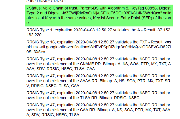

there is a check of your domain, ~~10 minutes old - https://check-your-website.server-daten.de/?q=mehrtakhfif.com
With an interesting result:
2020-03-31.mehrtakhfif.com
Normally, only one RRSIG 47 (NSEC) should be sent.
But you have two. One with a reduced bitmap RRSIG, NSEC, two different:
Bitmap: A, NS, SOA, PTR, MX, TXT, AAAA, SRV, RRSIG, NSEC, TLSA
Bitmap: A, NS, SOA, PTR, MX, TXT, SRV, RRSIG, NSEC, TLSA, CAA
That's curious. Bitmap -> these entries exist.
So the first row says: You don't have a CAA. The second -> you have one.
May be a bug in my tool. May be a delayed result. You use ANYCAST.
  • Wait some minutes, try it again
  • add a CAA with mehrtakhfif.com as domain name.
Unboundtest - https://unboundtest.com/m/CAA/mehrtakhfif.com/HAKD2KYZ - is happy. NoData, NoError.

If your dns provider doesn't support CAA entries, that's bad. But then you can't create one.
Something seems to be wrong with your NODATA responses. I can't tell what, though. It's not specific to CAA -- other query types, like www.mehrtakhfif.com AAAA or MX also fail.
If you turn up Unbound's logging, it says "NODATA response failed to prove NODATA status with NSEC/NSEC3".
Knot Resolver and 8.8.8.8 can't resolve them either.
(Conversely, BIND and PowerDNS can. I might have an idea why: They may query for DS, to which the authoritative servers incorrectly say that there is an insecure delegation(!), so they turn off DNSSEC validation for the tree and don't have as much reason to care about other problems.)
For now you should consider switching to a different DNS service or turning off DNSSEC. You're not getting much out of it anyway.
(It's not relevant to this, but they also ought to fix handling of unknown EDNS options and types. And stop using algorithm 5.)
Looks like a Cloudflare-style NSEC black lies implementation. Cloudflare calls the type bitmap approach "DNS shotgun". If you query for nonexistent type X, it says "every (supported) type except for X exists". If you query for nonexistent type Y, it says that "every (supported) type except for Y exists".
It's valid as long as you do it right and each response is internally consistent. It's effectively the same thing as what would happen if the user kept adding and deleting records, which is of course a perfectly valid (while weird) thing to do.

And there is such an answer
DS-Query in the parent zone has a valid NSEC RR as result with the domain name between
the NSEC-Owner "www.mehrtakhfif.com" and the NextOwner "\000.www.mehrtakhfif.com".
with \000.
I use Xml internal (external check -> database stored procedure), an older check crashed because of an Ascii(0). So I've added such a replacement.
