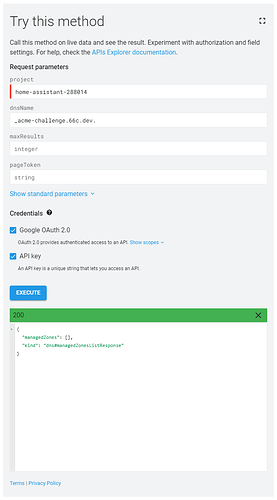

I'm using some very sophisticated instrumentation technology (lots of print statements) and it looks like the google API is returning 0 managed zones in the response for _acme-challenge.66c.dev. Here's the GET (from certbot):
GET https://dns.googleapis.com/dns/v1/projects/home-assistant-288014/managedZones?dnsName=_acme-challenge.66c.dev.&alt=json
Google has an API explorer that lets you handcraft calls in the browser (and then it handles auth for you). And I can see from there the response actually is empty:
So I'm going to have a sniff around in my account settings / see if there have been any changes to this API.
