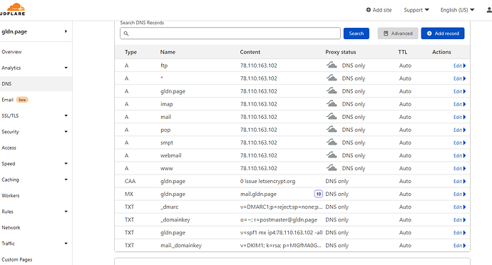

These are my DNS entries ...
Have you tried increasing --dns-cloudflare-propagation-seconds as stated?

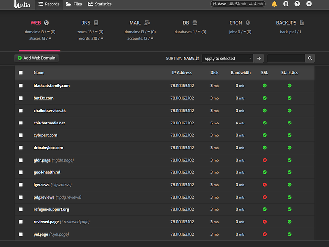

I do have other LE certs - which HestiaCP was able to get created.
( But HestaCP can't do the wildcards )
see image below.
Question ... is there any problem with creating them in these different ways?

I meant that the domains I am using wildcard certs for I have managed ( with your help) to get created using the command line.
The other domains you see in the image have had their certs generated by HestiaCP scripts.
HestiaCP updates the apache Virtual Host configs with the path for the LE Certs.
EG for drbrainybox.com it added ...
 SSLEngine on
    SSLVerifyClient none
    SSLCertificateFile /home/dave/conf/web/drbrainybox.com/ssl/drbrainybox.com.crt
    SSLCertificateKeyFile /home/dave/conf/web/drbrainybox.com/ssl/drbrainybox.com.key
    SSLCertificateChainFile /home/dave/conf/web/drbrainybox.com/ssl/drbrainybox.com.ca
I guess that for the domain gldn.page that I have just got the certs for, I need to update the Vitual host manually ? Is that correct ?
