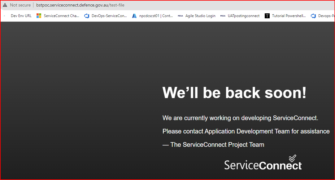

Hi rg305,
Thank you for your response.
I could not create the path with .well-known\acme-challenge in Windows. It won't accept dot in the folder name.
Screenshot attached of the path that we have.
Ran the command below (without the .well-known\acme-challenge)
echo "test" > "C:\Program Files\Apache\Tomcat 9.0\webapps\ROOT\.well-known\acme-challenge\test-file"
Checked that the test-file is there and contains text ''test''
Also the url below can be accessed from the Internet. Screenshot attached.
http://bstpoc.serviceconnect.defence.gov.au/test-file

Your domain is replying with a 502 error for any request. Even your home page as I noted earlier in post #5
You would get that same error just trying your domain name in a browser without any URI path at all.
Don't you have any IT support people you can talk with? A 502 for an HTTP request to your home page is not related to Certbot or Let's Encrypt. We are not a general purpose help site for all server configuration issues.
Maybe something is rejecting all HTTP requests. I don't know. You or an IT team would know better how your system is setup. Ask them why your home page fails with a 502.

Thank you so much for clarifying issue was not with certbot.
We have checked with App Server team and they had backend port redirection setup from port 80 to 443 which caused the issue. Once removed, we are able to install certbot.
