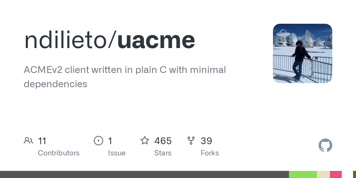

Other than the ideas already suggested, you could look at below. It handles TLS-ALPN challenges and passes through anything else unchanged to your webserver.
It does require exclusive use of port 443 so you'd have to change nginx to listen on some alternate port and pass through from this to that new port.

Just curious why it would. Requests inbound on port 443 get seen first by the uacme proxy handler. If it is a TLS-ALPN request it processes it. If it is not it passes it unchanged to nginx on some other port. Front-end proxies often proxy to backend servers on alternate ports.
