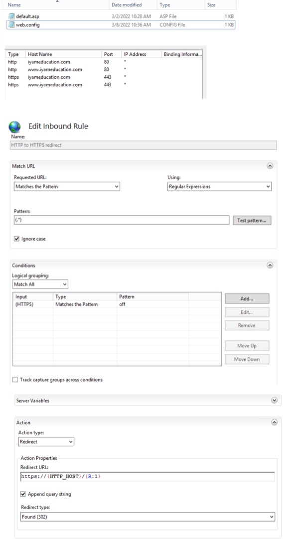

Thanks for the continued help. The site is about as simple as it can get. There is the default page and the web.config file with in the same directory. I've uploaded screen shots of all the key screens.

Sorry I wasn't doubting you at all, just supplied the above incase it cast any light on why it wouldn't be. I can't currently see what I have missed. I know the web.config I've pasted the rules into is the correct one because I can break it and get an error in the browser.
This is the web.config as it stands

The 'Test' button works ok on the URL section but when I used the 'Test' button on the conditions rule I get this.
The {HTTPS} server variable is given a value of either ON or OFF, so your test would be either of those values (in upper or lower case). The rules says if HTTPS is off then redirect to the original url with https:// instead of http://
Note as an aside:
  • The https pattern is a regular expression so technically it should be ^OFF$ but just using off works ok for me. Maybe try the regex version instead? Also do a restart if you haven't done one recently. you might get away with just restarting IIS but either way this URL rewrite module needs to be loaded by IIS.
  • The example redirect pattern https://{HTTP_HOST}/{R:1} would redirect http://anything.microsoft.com to https://anything.microsoft.com so you need both http and https bindings for all your site name combinations for that to work. Personally I also like to force requests to a canonical url e.g. https://microsoft.com/{R:1} would redirect http://anything.microsoft.com/test.aspx to https://microsoft.com/test.aspx
It seems more like that zoomed-in section is being taken completely out of context.
@IYAM
Please zoom out and show more/all of that page.
Normally "regex" patterns tests are to check the matching on the data provided just above it.
[NOT an ON or OFF selector switch]
In your post we can see that "off" doesn't match "www.iyameducation.com" via the result:
"The input data to test does not match the pattern"
But we have no idea who/what/when/where/why that data is being used.

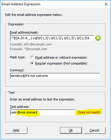

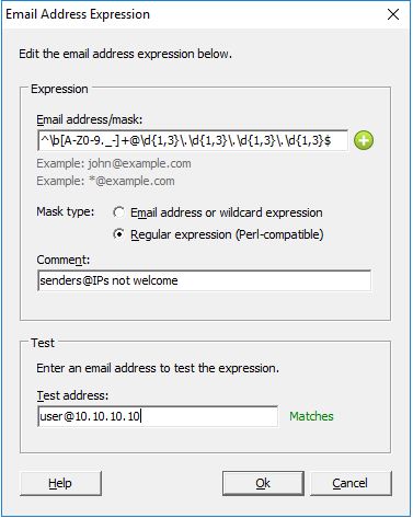

Here are two "regex" examples that match only when the email address is @ an IP.
This one matches:
This one doesn't match:
