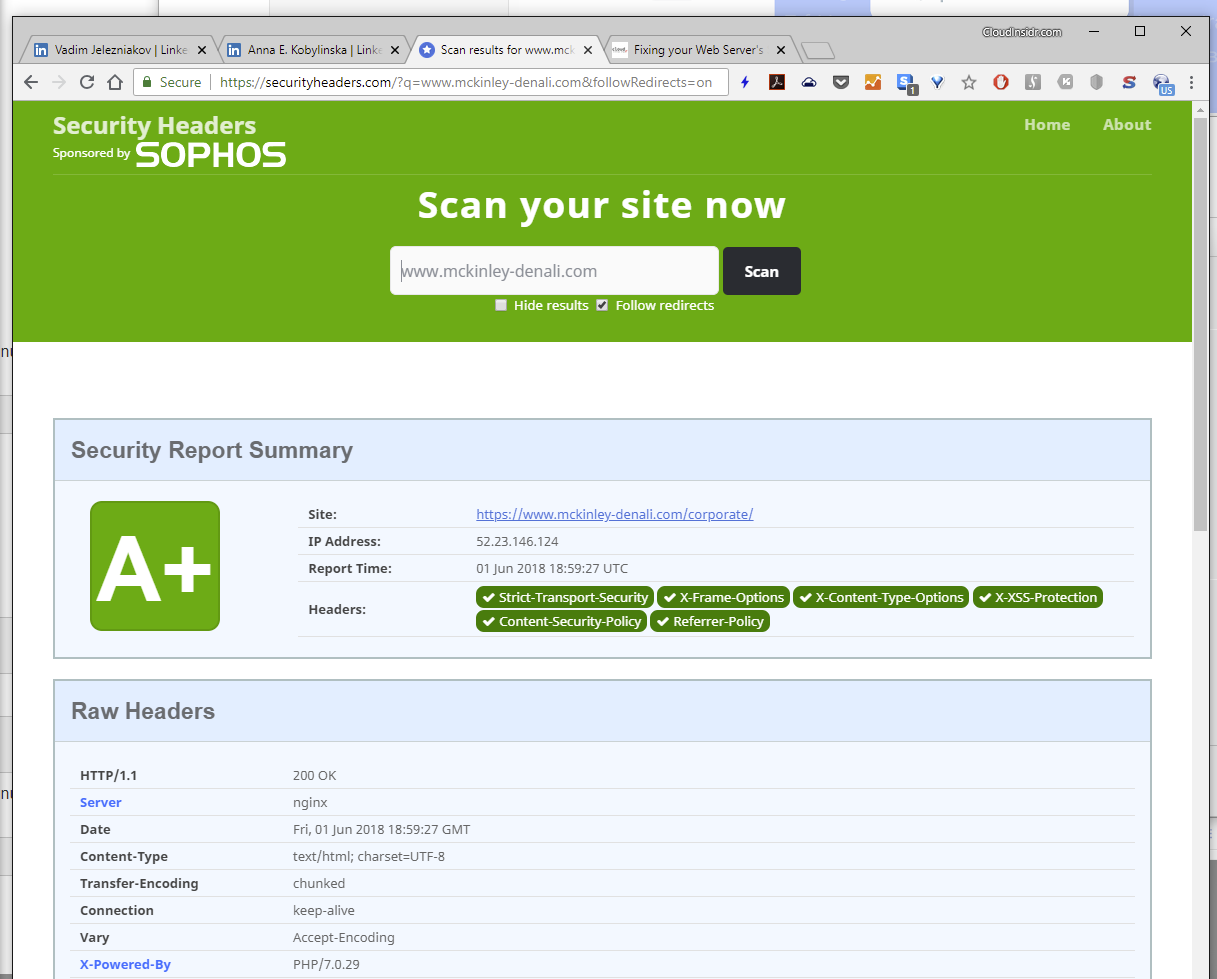

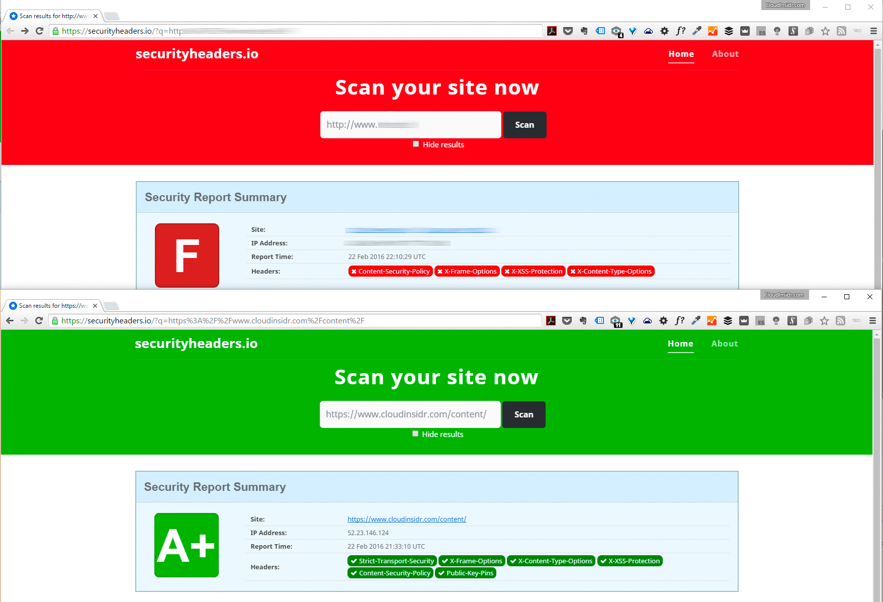

We also implemented HTTP Public Key Pinning (HPKP) as you can see in the attached screenshot and described in:
"Pin your public keys
The Public Key Pinning Extension for HTTP (HPKP) tells a web client to associate a specific cryptographic public key with a certain web server so as to prevent MITM (man-in-the-middle) attacks with forged certificates.(…)"
Here is to do it:
Filipe
