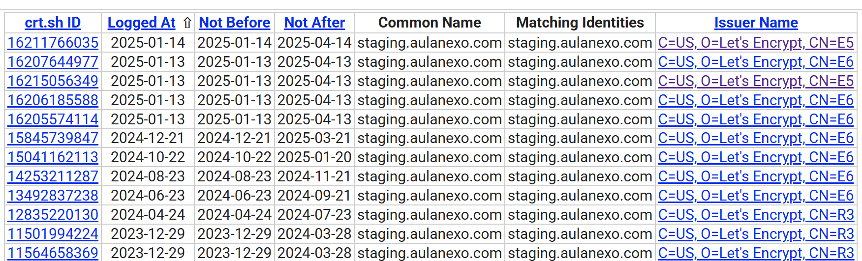

It is looking like ECDSA cert may be an issue. But, you got an RSA cert earlier today, and an RSA cert yesterday, and several more in days just prior to that. All the R10 and R11 certs are RSA. The older ones with R3 could be either but probably were RSA given this pattern.
So, a little puzzled why the only one that works is nearly expired.

I don't know either. The ECDSA is probably Not related. This latest domain has been using ECDSA certs since 2024 June. (The E5 / E6 are ECDSA intermediates).

But what do you recon? Let's Encrypt hasn't changed anything in the contents of the certificates recently as you can see at API Announcements - Let's Encrypt Community Support.
You can check yourself as you've shown yourself earlier at Renewed certificate does not work in Tomcat - #16 by VictorCoya. Except for the usual changes in serial number, public key and signature they are identical.
Maybe ask a Tomcat specific support channel, as the error message isn't helping me at all either. I have NO clue what so ever what Tomcat is complaining about exactly.
The only thing I can think of is the earlier mentioned RSA vs ECDSA, but from the posts above it doesn't seem like that is it.. So I'm at a loss regarding the certificate :man_shrugging:t2:
