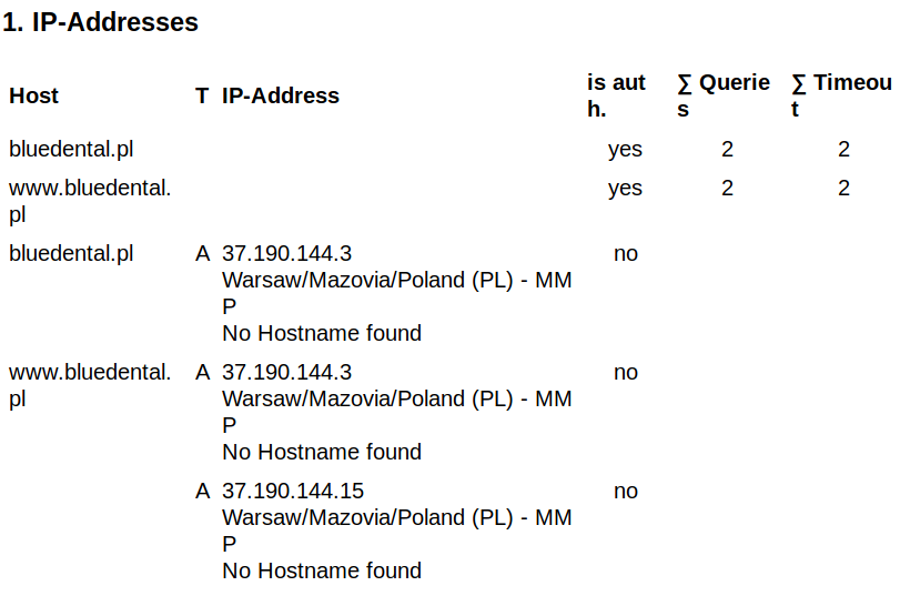

As You can see this configs not work as I supposed
https://check-your-website.server-daten.de/?q=bluedental.pl
That maybe more a problem of my tool. I have to find a solution querying the raw dns NS result which sends additional ip addresses of the name servers with the same domain name.
