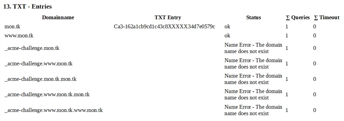

Bon après quelques recherches et nombreuses mises à jour, je pense que j’ai un problème avec mon DNS : Mon champ TXT est vide, pas d’"_acme-challenge". Normalement ce champ avait du se remplir avec le plugin ’ cloudflare credentials" et resté non ?
Sur https://check-your-website.server-daten.de
Misconfiguration - http-status 400 - 499
https://mon.tk/.well-known/acme-challenge/check-your-website-dot-server-daten-dot-de
Fatal: Check of /.well-known/acme-challenge/random-filename has a http status 401 / 403 Not Allowed / Forbidden. A http status 404 - Not Found - is expected. Creating a Letsencrypt certificate via http-01 challenge may not work. Trouble creating a certificate?
Use https://community.letsencrypt.org/ to ask.
Je chauffe ?

that's not relevant because you want to create a wildcard certificate. So you must use dns validation, not http validation.
And there is no check of mon.tk. Read the #txt part.
But I don't know how that
works.

i use this command to create my first certificate :
sudo certbot certonly --dns-cloudflare --dns-cloudflare-credentials /root/.secrets/cloudflare.cfg -d mon.tk,*.mon.tk --preferred-challenges dns-01
there is the TXT part
i change nameserveur
With dig -t TXT _acme-challenge.mon.tk i get :
