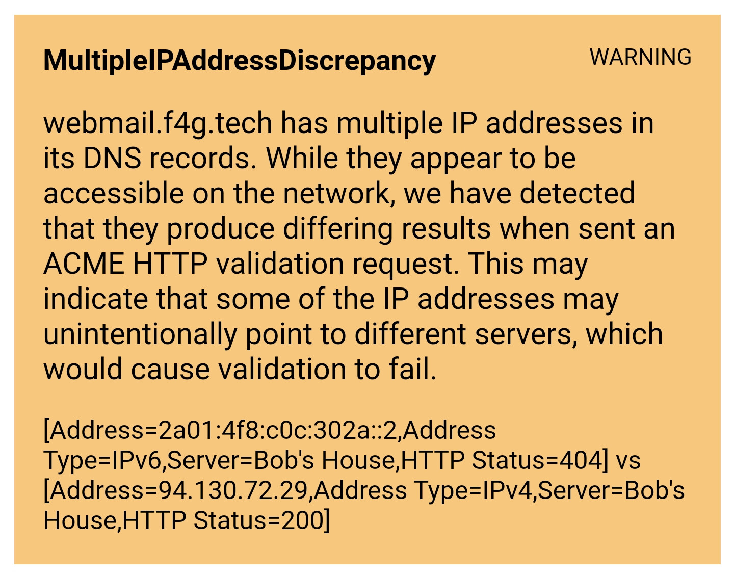

OK. I am still getting this for webmail.f4g.tech:
Screenshot 2021-04-19 202816
I am in Brazil. Let me try a VPN.

I think it's the IPv6 specific vHost that might be interfering.
:open_mouth:
I've checked incognito in chrome and get the same and the debug URL is not found here.....? Weird
Anyway, pls check debug link now.
We can ditch ip6.f4g.tech for now.
Bingo! :grin:
Borked IPv6 strikes again!

PS Disabling ipv6 on my network adaptor allowed me to see what you see in Chrome. Can we prevent certbot from using it?
I'm still out at lunch, but I wanted to say that your IPv6 address (AAAA record) itself is fine. It's that first vHost set to answer the IPv6 address specifically that was causing most of the issue. You should be able to simply disable that vHost for now instead of removing the IPv6 record and have things work correctly. Changing that vHost from IPv6:80 to *:80 should work too.
