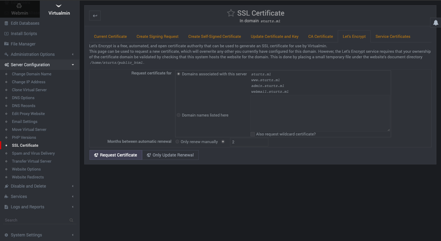

What exactly does that entail? What command did you run? Or did you click something in the configuration panel? I'm asking because the VirtualMin documentation is very sparse about this and I can't seem to install Virtualmin on a virtualbox CentOS (something about a GPG key missing..)

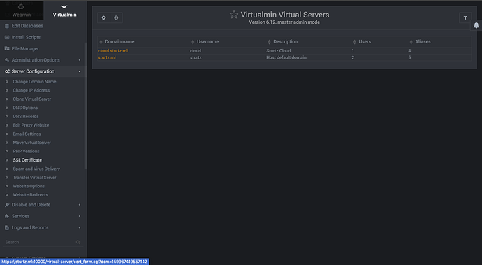

Interesting. Because in that last screenshot, Virtualmin claims it uses the http-01 challenge (the "small temporary file under the website's document directory"), but in fact it tries to use the dns-01 challenge:
Did you get the output from your first post somewhere from the Virtualmin error log or something? Also, I can't find any reference to certbot in the Virtualmin-GPL source code.. Did you by any chance run certbot from the command line in stead of through Virtualmin?
The resolution of your screenshot is too low (resized somehow), could you please upload the actual resolution so it’s readable?
Although I’m not sure if it would help… As I said, the documentation of Virtualmin about Let’s Encrypt is practically non-existent.
Do you just want me to copy and past the text? I had to zoom out for the image
is this better?
Yes, much better, thanks!

No clue yet… I’m just looking at the web-based auth first (first screenshot), because I have absolutely no idea how Virtualmin manages the DNS-based authorization. I mean, did you somewhere enter your CloudFlare DNS credentials in VirtualMin? Because I see your domain is hosted on CloudFlare and Virtualmin would need access to that for DNS-based authorization.
If we concentrate first on your webbased authorization errors, we see that:
  • admin.sturtz.ml doesn’t exist in the DNS system: no A or AAAA record. And without an IP address to connect to, Let’s Encrypt can’t authorize that hostname
  • same goes for the webmail subdomain: doesn’t exist
  • your www subdomain and base domain do have an AAAA record for 2604:99c0:8:2f96:223:24ff:fe08:581f. However, that host is down: I can’t ping it and I can’t connect to port 80 or 443. So Let’s Encrypt can’t authorize those hostnames either.
So my suggestion, unless you can explain me in detail how the Virtualmin DNS based authorization works exactly, is to get your site up in general again. Perhaps update your DNS if you’ve changed IP addresses?
all admin.sturtz.ml dose is it redirects me to the webmin port https://sturtz.ml:10000/
webmail goes to http://sturtz.ml:20000/

Which might be because you do have a "admin.cloud" subdomain, but not a "admin"? I don't see it anyway.
