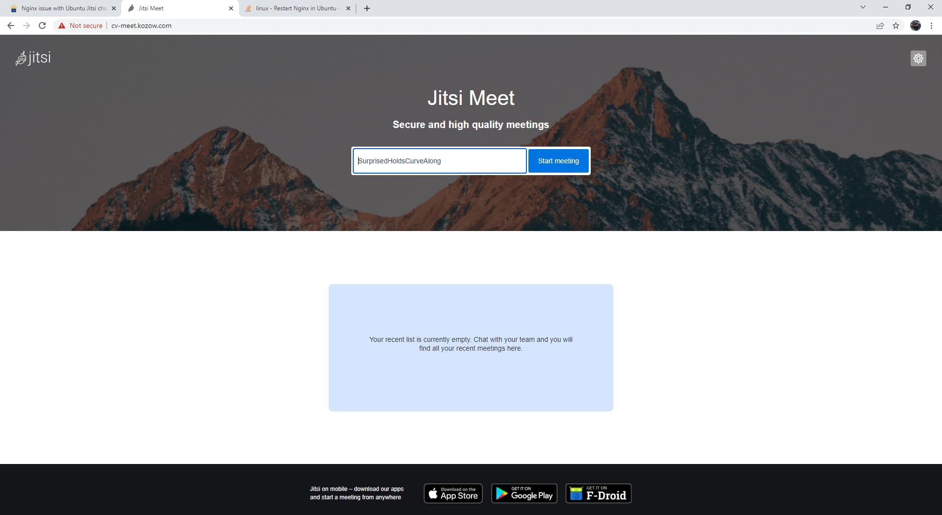

Yes, I read Jitsi's documentation and also a pretty well written tutorial. It seemed pretty straight forward. I like to keep my data and services in-house for my small business. This strictly a virtual machine to host Jitsi. There is a good bit of info on administrating it. The purpose of this Jitsi server is to host my own video conferencing when need be.
It is indeed working, however without https.
No, even HTTP is not working. It may be working on your local network but it is not working from the public internet. See this test site:
I do not know jitsi at all and others have said it can be very difficult. So I could not help with that but so far it seems you are missing very basic parts.
Looks like we are on much different time zones. I see your site just fine and your http even redirects to https which is good. The problem is your server is sending out a self-signed certificate. These will be shown as not safe by browsers as you have learned.

Like this? Please excuse my ignorance, I appreciate all your help and I hope I'm not frustrating you with my lack of knowledge.

It looks like we are getting somewhere! Https is working! Is there anything else? Chrome says not secure. Again, I'm not L33t for understanding website stuff. :joy:
Yes, we need to re-do the certbot certonly command with different values so that cert renewals work.
And, did you restart Chrome? The certs look good to me and this website Sometimes browsers cache old results.

If it is still failing click on the 'not secure' red triangle area and say what detailed message is.
