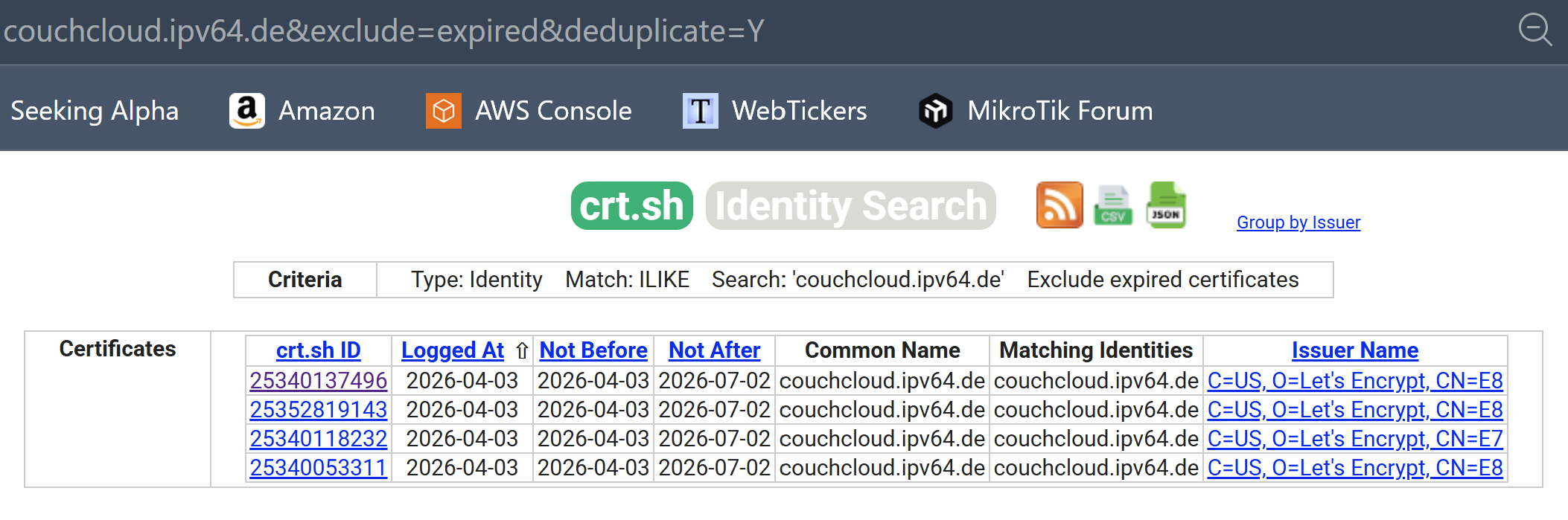

I see you got a cert today for npm.couchcloud.ipv64.de and that is the cert used when making requests to couchcloud.ipv64.de. That is why it is "untrusted" because the domain names do not match. That is something wrong in your NPM setup and you would be best to ask them about that.
NPM is a configuration tool which is difficult to debug when things go wrong. Best place for advice is with NPM support or their community experts. We see NPM regularly so I say this from experience :slight_smile:
I also see you got 4 certificates for just couchcloud 2 days ago. You should be able to use one of these now. Again, the NPM experts should be able to explain what needs to be changed in their configuration.
