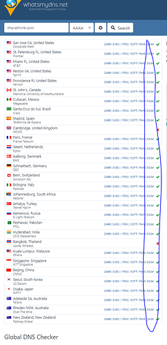

We upgraded to a new VPS in November and that IPv6 address is the older server. I think this is the problem.

Have confirmed this is a DNS resolution issue, seemingly as a result of Linode having bad nameserver information, despite records being confirmed as setup correctly.
The German one at the bottom too
and Russia and France
Correct, however very few visits from those locations but regardless, yes. The USA registrars are what we need resolved asap; have contacted Linode about this directly.

As instructed, I had to delete and recreate their nameserver domain records to have them repropogate across DNS servers. Will take some time to resolve but should be fixed.
