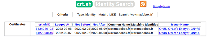

What I notice is that https://wsv.madobox.fr/ is serving a certificate issued for wsv.gtbox.fr...
The cert is valid till April.
wsv.gtbox.fr is serving the same certificate and it seems to be working correctly. (Page is blank probably cuz you are working on it.)
So all you need to do is configure this cert and you should be good to go:
crt.sh | wsv.madobox.fr
Of course you knew that!
Hope this helps.
