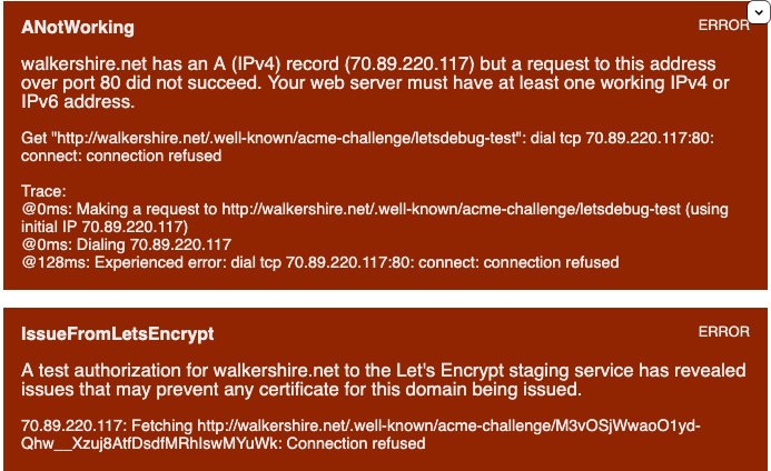

It may also be worth seeing what happens after you stop apache like you did earlier. Leave it stopped and see what response occurs for HTTP and HTTPS requests.
Use a tool like this to check some domains: https://letsdebug.net
If you still get replies that is positive indication of multiple Apache

Right now I can't connect with HTTP or HTTPS to walkershire.net
Are you saying that you now have a single Apache for all the domains? Or are you still splitting them. Because almost certainly something about that split was causing the earlier problem. I asked about multiple Apache quite a few posts ago :slight_smile:
All are now on one computer with one Apache. We will try to split them next year.
