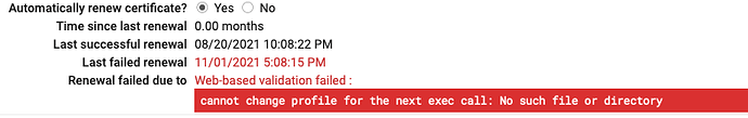

I ran this command: "Request Certificate" via UI in Virtualmin.
It produced this output: Requesting a certificate for awards.botany.org, www.awards.botany.org from Let's Encrypt ..
.. request failed : Web-based validation failed :
cannot change profile for the next exec call: No such file or directory

The above domain currently has a valid letsencrypt cert on it, but these errors started happening when renewal time started.

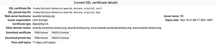

There may be an issue with the two other names included in the cert:
X509v3 Subject Alternative Name:
  DNS:awards.awstemp.botany.org     <<< HTTPS NOT WORKING !!!
  DNS:awards.botany.org             <<< HTTPS     WORKING
  DNS:www.awards.awstemp.botany.org <<< HTTPS NOT WORKING !!!
  DNS:www.awards.botany.org         <<< HTTPS     WORKING

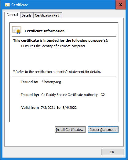

They are attempted to be served via this wildcard cert (which lacks coverage):
Given: The HTTP authentication requests won't need to connect via HTTPS, it just seems indicative of the lack of coverage by your (VirtualMin) system for those names.
The missing subdomains are a result of me cleaning up my configuration. They were valid last time I had a successful renewal but were targeted for deletion. When I started getting THIS error, I decided the time had come to simplify and removed them. So the renewal of the cert isn't QUITE exactly like the previous one.

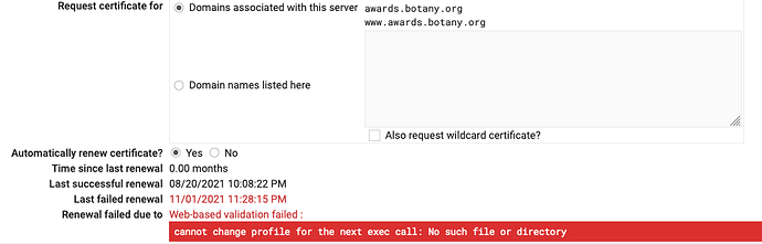

A little bit larger screen shot:
Shows that Virtualmin is trying to renew the default domains, and that if I wanted to I could do a custom list of them if the default isn't appropriate. And I can tell you from experience :wink: that when the domains aren't "right" you get an error message that tells you so. So unless there's a brand new bug somewhere, I don't think those recently removed subdomains have anything to do with the issue.
