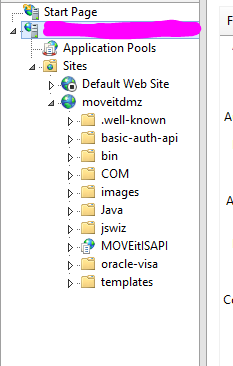

i usually create a .acme-challenges directory for each site (iis site not binding).
That means i dont have to rebind and the authentications will work.
Could you be more specific? You’re saying under Default Web Site with a subdirectory Autodiscover you then create a subdirectory of Autodiscover called .well-known and that allows you to get a SAN with autodiscover.yoursite.com?
nope i create a directory at the root.
below is an example.
