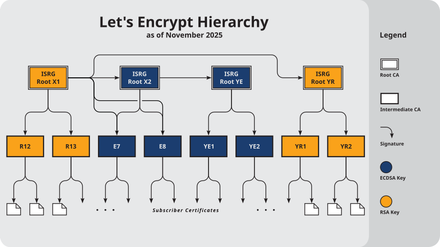

What's the default chain going to look like for ECC leaf certificates?
From New "Generation Y" Hierarchy of Root and Intermediate Certificates - Let's Encrypt, it looks like it will be EE < YEn < YE < X2 < X1 ?
Or will there be a YE < X1 cross-sig as well, to make a shorter but still widely compatible default chain?
Correct. YE will need to go via X2 to chain to X1.
You can see the full docs in a PR at Update Certificates doc to show issuance from Gen Y hierarchy by aarongable · Pull Request #2068 · letsencrypt/website · GitHub
which has an expanded diagram:
Chains of Trust - Let's Encrypt
