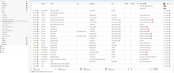

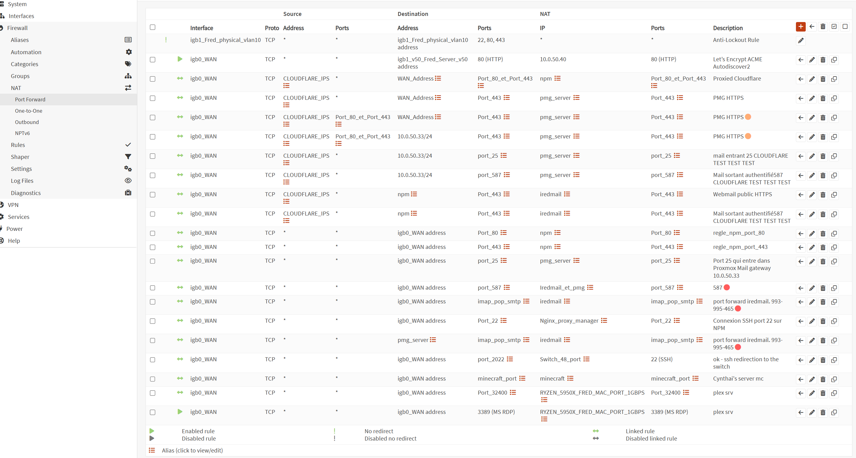

here my nat:
here my opnsense rules.
here my vlan 50
