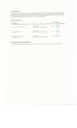

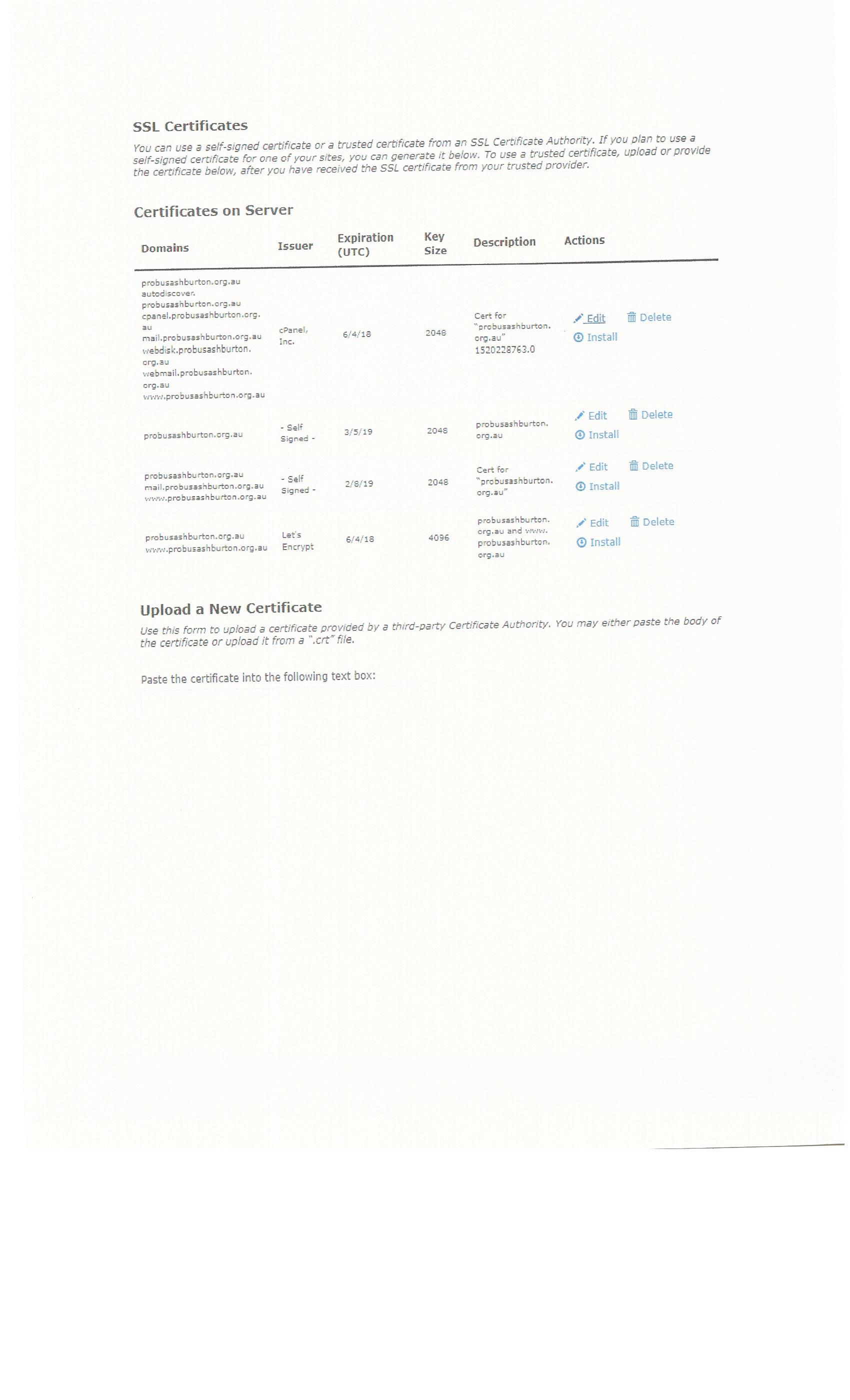

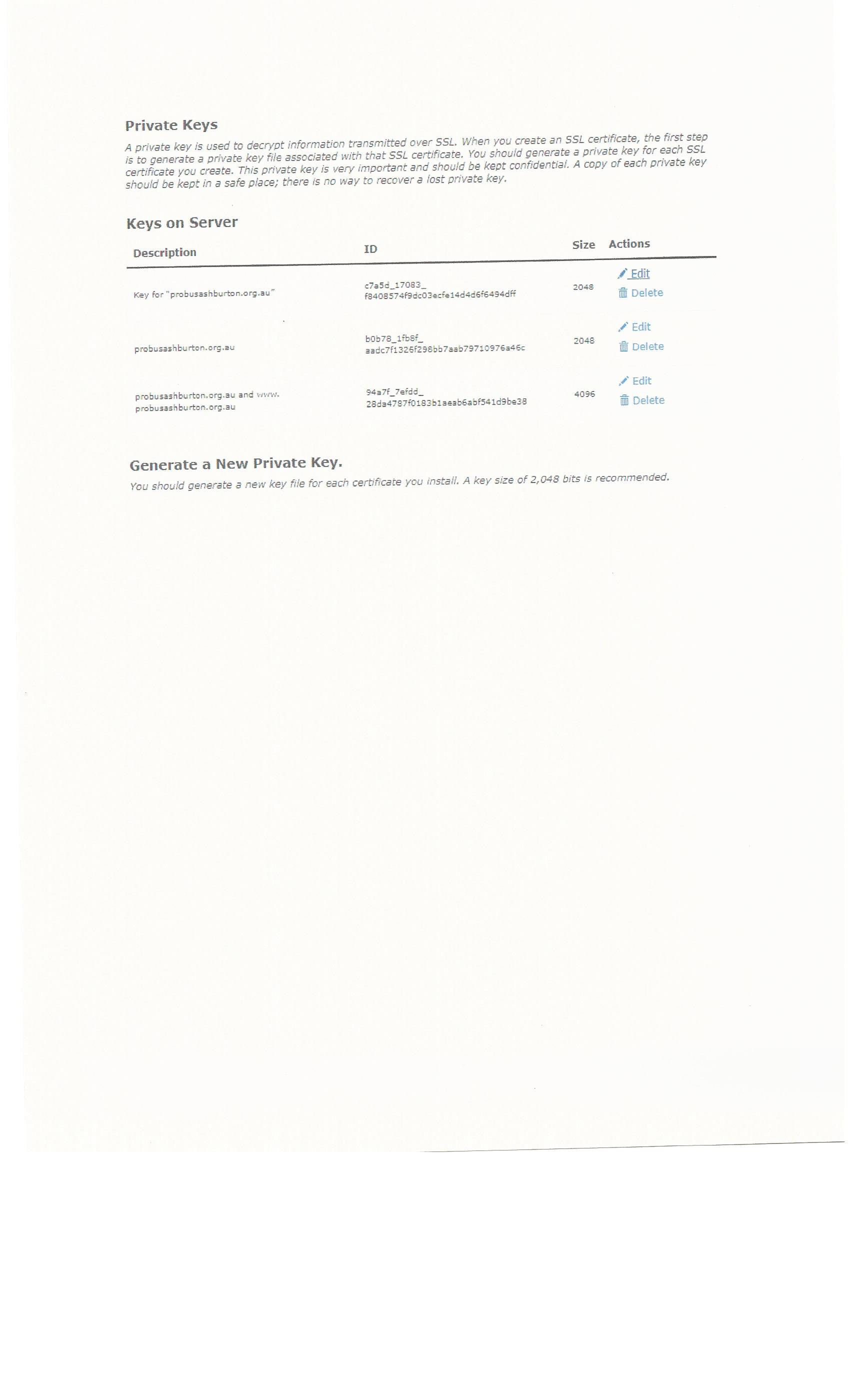

Maybe you could make a screenshot as a JPEG?
I am converting the document to a JPG file now
Here they are, hope you can read that…

@_az, do you have an idea of what’s happened here?
No, that’s why I uploaded the screen shots
Since the cPanel server has AutoSSL enabled, I don’t see any reason to use Let’s Encrypt for this website. cPanel will automatically issue and manage SSL certificates for your domains, which it has already done for you.
Your other issues are because of mixed content as @schoen mentioned, and the only way to fix this is to make changes to the code of your website. The reason that some browsers may render it differently is because they have varying policies in insecure/mixed content.
I was hoping for @_az's input, and now we've got it. :slight_smile:
So, I don't know what was wrong with the cPanel situation at the outset but perhaps your hosting provider has fixed it. In that case I guess you don't need to use Let's Encrypt at all as long as you're hosting in this environment and nothing changes.
Your cPanel certificate expires on June 3, 2018, so you might want to check in mid-May to ensure that cPanel has automatically renewed it for you. You can see whether this has happened by looking at the certificates in the cPanel interface (as you did above), or by viewing the detailed certificate information in a web browser when accessing the site.
